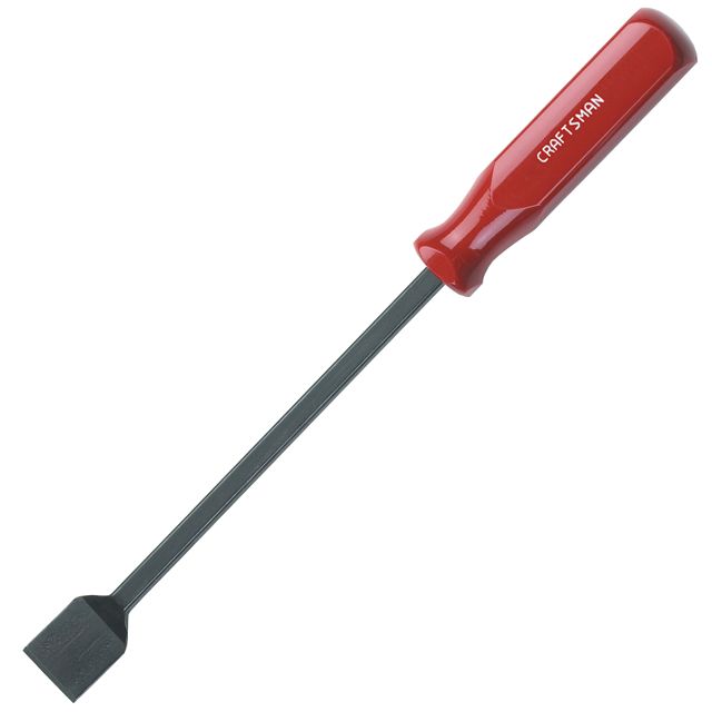

    Removing a cover even when it is not painted on is something that requires your focus and care. A panel that slips from your hands can and has fell into the mains causing instant flying molten metal from the arcing.
    How I deal with your situation is to remove the lower screws and see if I can break the cover loose while leaving the top screws installed or slightly backed out. The idea is to break the cover loose without it suddenly coming off completely.
    Now having said that not all covers are the same so I have a few tools that I use to break the cover loose. My favorite is a automotive gasket scrapper made by craftsman.
