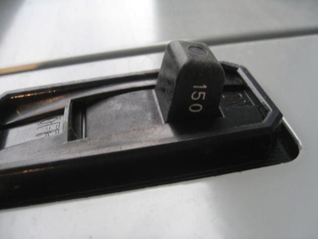

    I posted pictures of an electrical service panel spec plate on the outside of a commercial building. The panel specs list 800 amp max. There is a large 400 amp disconnect at the top of the panel. Two 200 amp disconnects, and one 150 amp disconnect (950 amps total). The 400 amp disconnect appears to disconnect power to panels on the 2nd floor. One of the 200 amp disconnects, and the 150 amp disconnect shut off power to panels on the 1st floor. I could not identify what the last 200 amp disconnect serviced (maybe an outbuilding). These all appear to be independent disconnects (i.e. the 400 amp disconnect at the top does not turn off power to any of lower disconnects). Is this too many total amps for the panel?
    Indidual disconnects:
    400
    http://i303.photobucket.com/albums/n...Photos/400.jpg
    Two 200s
    http://i303.photobucket.com/albums/n...tos/Two200.jpg
    150
    http://i303.photobucket.com/albums/n...Photos/150.jpg

    The total of the capacity of the breakers in a panel has (almost) nothing to do with the panel's rating.
    An example of this is that it is entirely legal to have 42 20 AMP breakers in a 200 AMP panel. What those breakers supply (the load on each of those 20 AMP circuits) is what determines if the panel is overloaded. If each circuit powers a 7.5 watt appliance lamp there isn't a problem. If, however, the load on each circuit is a 2400 watt heater and they are all in use at the same time, there's going to be some problems.
    The only way to know if the setup is OK is to have a load calculation done. Even this may not tell you a lot if equipment supplied by the remote panels has been changed or removed as often the case in a commercial building. Electric services and panels in commercial buildings are usually built around what is going to be installed by a given occupant with little or no thought to future use (nobody knows what the next occupant might need)

    Bill, The one difference I see is that in a 200 amp panel (with 42 20 amp breakers) there is one main disconnect that would trip if the total power usage ever exceeded the panel rating of 200 amps. In this panel, there is the potential (however unlikely) that 900 + amps could be pulled out of the panel and none of the main disconnects would trip (i.e. 390 from the 400, 190 from each 200, and 140 from the 150 = 910). I am trying to get an idea, if based JUST on this fact, it would be reasonable to recommend a licensed electrician, further evaluate and make adjustments / repairs as needed.
    Mar 2009
    Colorado Front Range
    601
    Default Re: 800 Amp Service Panel / 950 Amp in Disconnects
    Believe it or not, most commercial/industrial services can have the problem you're worried about happen. Services are designed with something called load diversity in mind, which is an assumption that all of the maximum loads won't be applied at the same time.
    The issue here is that whether this is a problem with the building in question is going to be tough to answer if the building is unoccupied as many of those loads aren't going to be present because they are partially dependent on what the occupant hooks up. THAT is the point in time when the question can be best answered.
    Whether or not what's there now can cause issues and is done per code can certainly be determined. If you're evaluating for a client that's going to buy or lease they need an electrician involved in the process. Any business moving into a building without having the electrical supply evaluated for their purposes is naive in believing they can just move in and hook up and all will be OK.

    The short answer is yes, but everything has to be evaluated on a case by case basis. Many times panels are supplied with larger feeds than they might otherwise have simply so they can start motor loads without breakers tripping. The branch circuit breakers for these circuits are also likely to have larger breakers on a given size wire than you're used to seeing.

    You have pictured a 208Y/120 3-phase 4-wire panel with a 400 A service disconnect for the 208Y/120 3-phase (A, B, C +neutral) 4-wire service.
    Apparently your panel has 3 circuit breakers below theservice disconnect, each protecting a 120/208Y feeder to remote panels: two 200A and one 150A, each being 120/208Y (poly {split} phase) feeders, such as AB, BC, AC (CA). There is no 950A traveling on any leg! protected at 400A or 350A max depending on which split legs of which phase(s).
    What was YOUR question again?
    Taking off the dead front cover is warned left to those qualified. Polyphase and polyphase Wye outside of your confort and training level, leave to a non-residential electrician.
    By the way, in this case there ARE Neutrals (they carry current).

    Here Bill I can assist HG with the math.
    400+(2*200)+150=
    simplified to 400+400+150=950
    800 amp rating from panel label.

    Unfortunate I "missed" or rather misread the "ML" designation in the cat. number...at first glance of the imbedded photo of the panel label, I couldn't at first easily enlarge it for easy reading as I could easily following the other direct links. Finally saw all that the panel label indicated, clearly and expanded, whoopee. Its a S4 MLO (main lug only) Sentron Power Panel, 800 Max Amps 208y120 3-ph 4-wire Wye secondary 60" High panel having Silver-plated CU Buss-Bar(s) top feed surface mount Sentron MLO Power panel. Have no idea if in larger can with feed through.
    No primary overall protection on board, possible line side.
    However, still don't see any concern or even how Jim Port, Bill K or the OP can "add" and come up with anything exceeding 800 Max Amps with three 2-pole circuit breakers 200A, 200A (in same photo) and 150A.
    For example,
    + 400 Amps 3P A-B-C 2nd Floor
    + 200 A 2P A-B First Floor occupancy
    + 200 A 2P B-C Mystery suspect nightime lighting (indoors/outdoors/parking lot) panel(s) not yet located identified; and/or other common building area system(s) - panel perhaps even AC on the roof for common areas, exterior receptacles, irrigation, signage, etc. - who knows.
    + 150 A 2P C-A other identified first floor panel
    does not equal greater than 800A and no where near 950A.
    In fact, if I'm not having an old-ager's brain *art: it equates to 750 Amps "A", 800 Amps "B", 750 Amps "C" on secondary Wye supply.
    Dollars to donuts your mystery 2P 200 breaker feeder circuit of unknown destination/function is a feeding a panel for lighting outdoors and indoors common areas at nightime, and likely clock, board, sensor/photo cell controlled, find the panel, likely a Lighting & appliance one.

    The Siemens Sentron panels have vertical buss, NEMA configuration, this is an S4 MLO power panelboard! The OP has indicated this IS Service equipment. It is NOT ME who is confusing THIS 3-Ph 4-wire Wye Secondary POWER PANELBOARD with a Lighting & Appliance panelboard.
    This is a 3 phase 4-wire wye secondary panelboard, it is a MLO pannelboard. Yes we DO add, we just don't add 2-pole breakers to a third non-stabbed pole as YOU, Mr. Port, have demonstrated.
    There IS no overage of the panel rating, those three breakers, 200A and 150 A are two pole breakers, the other is a 3-pole breaker; There are three true phases not ONE supplying this panel.
    This is not a single phase 3-wire service or power panelboard.
    You do not add AC to B you do not add BC to A you do not add AB to C. You do add what is on A to what is also on A; what is stabbed to B also to what is stabbed to B and what is stabbed to C to what else is stabbed to C.
    Everything stabbed should be on frame rating that is equal to or exceeding the panel rating its MLO, and according to OP nothing ahead.

    There was NOT 950 Amp in disconnects!!
    The Total present as photographed and described was 750-800 Amps Max value of disconnects/overcurrent protection per PHASE/BUSS.
    The "issue" is that both YOU and the OP, GOOFED with your "creative math".
    Off topic:
    Regarding your continuing "stalking" and cross posting: PROVE you were allowed (THEN) to mount a receptacle THROUGH a free standing side wall of an exposed "floating" BASE CABINET. Do it on the appropriate topic thread.
    You've cross posted what, half a dozen times.
    Back to the Topic HERE:
    YOUR MATH IS IGNORANT and WRONG (BOTH TIMES).
    3 Ph 4-wire Wye secondary Main Lug Only SERVICE panels.
    Obuscate and side track all you want, a LOAD Calc is NOT NECESSARY to ANSWER or address the Original Poster's ORIGINAL POSTED QUESTION on THIS topic - The question in the Original Post has NOTHING to do with "Load Calculations" that's a completely different subject; I know that's what you want to hide behind, but then again, it has NOTHING to DO with the OP's actual presumption or questions.
    Mr. K's response at post 7 to the OP's followup at post 6 is flat out wrong as pertains to the Original Question (e.g. in context) to the MLO service equipment panel as pesented and rating label pictured by the OP. There is NO way, and I don't care if you have a thousand motors load side on a rotating starting sequence, load diversity bull crap, that you are allowed to have more than 800 amps "worth" of service disconnects on any phase buss bar on THIS 800 A max rated Siemens Sentron S4 MLO service panel or for that matter your load can be as "diverse" as the wind, there cannot be more than six disconnects TOTAL, either. The OP is not a "load" question, you've just tried to make it one.
    This is a 1999 Ed. NEC Service Panel. 2000 UL White Book.

    My simple answer as an electrician....this is not a concern, as the load calculations we do when wiring a building have a derating component. I would have no concerns about this, but if you want more info, ask about the load calculations that are a requirement for the electrical permit when built. If not available, an electrical contractor can do one for you if there is a concern. To me there are no "red flags" here.
    Norm

    Norm is correct that there no red flags here. I also would go back to the orginal permit and look at he submitted load calculation and also see if there has been another permoits issued, that might have changed the load calculations. The other is the load balanced between the phases.

    Exactly, agree completely with two immediatly prior posters, there is no "950 Amp in Disconnects" and No red flags here - there are 750A-800A-750A on poles ABC respectively Disconnects in "800A" rated equipment.
    However, I throw an orange flag on the specifically photographed 150A 2P as questionable listed or classified compatible equipment for THIS described as installed MLO cat. no., vintage (mfg date), etc, in re: frame rating, etc..
