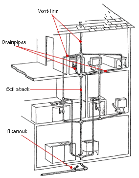

    Is it acceptable to dump the primary drain line into the vent? I say no. See arrow in photo.

    Your photo cut off, but no the AC cannot discharge into a plumbing vent.
    M1411.3 Condensate disposal.
    Condensate from all cooling coils or evaporators shall be conveyed from the drain pan outlet to an approved place of disposal. Such piping shall maintain a minimum horizontal slope in the direction of discharge of not less than 1/8 unit vertical in 12 units horizontal (1-percent slope). Condensate shall not discharge into a street, alley or other areas where it would cause a nuisance.

    No. It must be to an indirect connection and a trap must be employed to prevent sewer gas from entering the HVAC. That installation stinks, literally.

    What is/are the "Approved" place(s) of disposal?
    The code does not say.
    A trap should be installed on the drain line at the appliance.
    A second trap would not be approved.
    Like Jim, I think that an air gap with a 2nd trap is best
    But is it not to code?

    OK I'll bite.
    Just what code, Manufactures Instructions or Best Practice would allow anything ( not just AC ) to discharge into a Plumbing Vent Stack ?

    Ask your AHJ.
    * the vent stack would not be one of those.

    The real answer will come from the AHJ. In most cases I have seen condensate tie into vent lines and the inspector doesn't make an issue of it.
    IF you provide a trap in the attic it will freeze in the winter. If you are using a condensing furnace in the attic you'll have other freezing issues as well.

    It seems somewhat obvious the OP's pic is in an attic, and I'll assume highest level upstream side of the structure's/building's sewer.
    A CW&V system. Nothing to indicate other than just mechanicals in what appears to be the highest level/story of the structure (occupied attic) the wet vent may be dedicated solely for this purpose. Incorrectly altered/repaired but appears to NOT have been (originally) a dry-vent to begin with.
    Cruddy pic somewhat out of focus and doesn't show much other than incorrect fittings upside down in the OP, just addressing a wet vent in a combination waste (or drainage) & vent system.
    FYI most of the SW states did or do use UPC and UMC based code not IPC/IMC regarding same.
    Bottom line - not all venting is "dry" throughout, such as a combined waste & vent (wet vent), and there is no indication that the pictured is actually "attached" to the sanitary system and not some other such as gray system or indirectly discharging elsewhere below for that matter.

    That's not a "plumbing 'vent stack'", although there is a portion designated to "dry vent"-ing.
    As far as your general assertions/challenges for your own area, see ('09) IPC Ch. 2, Sect 202 (definitions) and Ch. 9, Sects. 908 (.1 & .3), 909 & 912.
    We cannot see behind the panel - therefore there is no conclusive evidence nor assertion by the OP that the connection from the condensate drain pan is anything other than indirect; it appears obvious it is above the trap weir.
    Despite the obvious indications that there are other problems at issue in this area, the concerns do not include as you represent.
    There is no indication that the assending (dry) vent pipe from the indirect waste piping combines with any sewer-connected vent, and that it does not extend separately to the outside air. Both wet vented 'fixtures' are within the same story/building level (attic, occupied and apparently at least partially may/could be "habital" attic).
