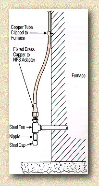

    Somewhere in the past, I read that the galvanizing process is better now than in the past and flaking is no longer a concern with using galvanized piping for gas. I'm often asked if the drip leg ever fills up and needs to be cleaned. It's a big country, so I'm sure that has happened, but I've never heard of cleaning a drip/sediment trap out.
    Here's an illustration showing a copper/steel pipe connection.
    You are right, galvanized production has gotten better. Boils down to here you are. Then there is the question of when was it made? Being old school (older than dirt) black is beautiful for gas lines.
