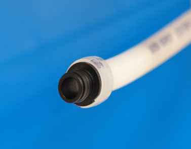

    Thanks Mike, that's good to know. However, one thing that I've noticed about the Wirsbo/Uponor product is that, though I've never physically measured the stuff or bothered to actual look at the spec numbers, it seems to have a thicker sidewall and overall diameter than some brands, and it all is connected with their proprietary method of putting on the PEX shrink-to-fit collar, expanding it with a special tool, shoving it onto the fitting, and then allowing it to shrink, versus the crimp fitting methods being used by other manufacturers.
    So, if it has a shrink-fit plastic ring, like the one shown in the photo on the EP fitting below, it is certainly either Wirsbo or Uponor, correct? However, it's gonig to be hard to tell, by just looking at it without looking at the roll markings, which other manufacturer's product you are looking at.

    If I pushed the right buttons , there is a Uponor tubing image below.
    The ASTM numbers to the upper right; (ASTM F1960, F1807, F2023, F2080, F2098) are all fitting "types" they approve for use with the tubing.
    The "cold expansion" type fitting with the reinforcing ring that most of this is currently connected with is ASTM F1960, but it is possible to see other types used, and they would be acceptable for use technically, if in that list.
