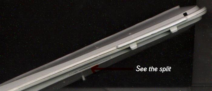

    Default Re: Mr. HandyMan strikes again
    Obviously if the DW leaks only when in operation, it's not the fill hot water line, which is under pressure and would leak all the time. Check the discharge line - you will have to pull the DW out of the cabinet. It may be looped upward with a small pin-hole leak. In my experience it's not unusual for the line to kink up as the DW is pushed into the cabinet. Once the DW is outside the cabinet, run it again to locate the leak. You might also try pulling on the discharge hose from the 'other' side of the cabinet it is fed through, to see if it will straighten out. Typically DWs will discharge residue/water inside the machine before actually starting to cycle - some machines, particularly Bosch - can hold quite a lot of water. It's a design thing and helps keep seals lubricated.
    A couple of months ago I examined a faulty DW on behalf of an Ins. Co. and claim. A small plastic elbow had cracked at the pump where the discharge line is connected and the machine cycled overnight, spewing water onto/under the hardwood kitchen floor instead of being discharged in the normal manner. Actually the homeowner didn't realize what had happened - most of the water was behind base cabinets and under the flooring - and inadvertently re-cycled it again the next morning before leaving for work. The floor got a double dose. Cost of the replacement part $1.98. Cost of the damage and insurance claim, which included weeks of dry-out, removal and replace (almost 1000 sq.ft) new HW floor, replace 2' of perimeter drywall, remove and replace base cabinets, replace baseboards, molding and paint - over $23K.

    "Some leaking around-under-from the door on dishwashers can be traced back to a split in the spray arm. If the lower spray arm develops a split in it, the spray arm can turn too fast, and shoot water directly at things that it is not suppose to spray water at....sprays water at the door vents or edges and can create water leaks."
