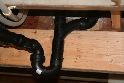

    I believe in my contributions to this Fine Homebuilding discussion:
    http://forums.finehomebuilding.com/b...c-floor-joists
    Associated writing:
    http://energyconservationhowto.blogs...ic-floors.html
    Copy from that blog post:
    This post was imagined, in dealing with structural analysis of composite beams, as presented in another public forum I have joined, DIY Chatroom:
    http://www.diychatroom.com/f19/strengthen-ceiling-joist-151512/#post1046734
    Perhaps readers here will see value in composite beam construction, and might comment. I think floor reinforcement by "sistering" has no validity, where added lumber couples that found, with rotational freedom and unlikely bearing on supports below.
    I wish for academic and professional comment. Lacking that, I can attempt my own defense. The ultimate would be deflection testing of sample beams, which is within my capability, but would best happen with support of an interested college or university. For now, note that beam stiffness and strength are in linear proportion to thickness, and cubic to height. Sistering at best doubles strength. A composite 2x10 is likely at least four times stronger than a 2x6, and more than ten times stronger than a 2x4. A composite 2x12 of the same 2x lumber is strengthened by a further factor of two. What wonderful and easy control of strength! Testing and questioning are hardly justified. Does it matter that you might increase 2x4 strength by times thirty? Maybe it is just the added insulation depth that matters. Often it is sufficient to just do all that the situation allows for strength and insulation, as in availability of headroom. Sistering is best effort, only if space for making the floor thicker is absolutely unavailable.
    Interest in this has appeared in a re-post to Fine HomeBuilding. I have graphics to share there, which I will copy from expansion of this post. I explain in a further example, that of the repair and strengthening of a 2x8 floor joist in my crawl space. Here is a photo.
    And, here is a cross-section detail. This beam bears more load than any other in my crawl space, yet suffers a carve-out passing the bathtub drain. I go way beyond compensating for the divot. Surely the reinforced beam is as strong as a joist of 1 1/2 x 12" cross section, better strength is by the ratio (12/7.25), cubed. That is, by times 4.5.
    I worried some about that beam before my remodel. I won't anymore.
