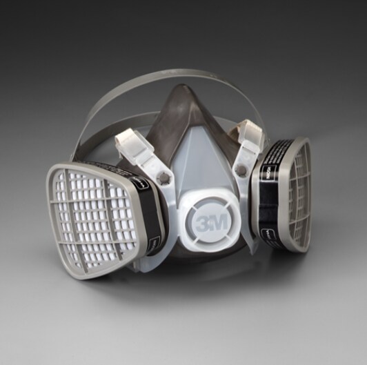

    Sean; Regardless of what it is---Please always use a mask. I am constantly inspecting dryer vents in attics and crawls. I ALWAYS use a mask. Mine is an Automotive Paint Mask by 3M. About 30 dollars at Lowes or Home Depot. Filters are particle and vapor and changed every 100 hours of usage or until the filter indicator turns completly black, then it is time to change filters. Save the lungs Brother!!!! Here is a picture
